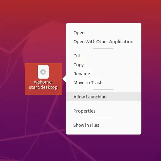

To create a shortcut that executes a script with root permissions on Ubuntu 20.04, you can use:
  1. Add the following line to /etc/sudoers (sudo gedit /etc/sudoers)
    • YOURUSERNAME ALL = NOPASSWD: /script/path
  2. Create a desktop shortcut:
    • gedit ~/Desktop/myshortcut.desktop
  3. Add the following content:
    #!/usr/bin/env xdg-open [Desktop Entry] Version=1.0 Type=Application Terminal=false Exec=sudo /script/path myarg Name=Shortcut Name Comment=Shortcut Comment Icon=/usr/share/icons/Humanity/actions/16/media-playback-start.svg
  4. Right click and the shortcut and choose Allow Launching:
