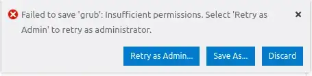

Just in case you want make changes to a single file I would prefer the following approach.
  • Run vs-code as regular user.
  • make changes to file
  • File -> Save or press Ctrl + S
  • vs-code will pop up error in right bottom corner saying
    Failed to save 'grub': Insufficient permissions. Select 'Retry as Admin' to retry as administrator

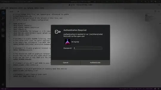

  • Click on Retry as Admin. It will ask for administrator credentials
  • Enter credentials and enjoy saving files with vs-code.
