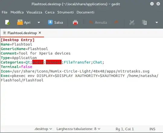

I made a .desktop file for Androxyde's Flashtool (utility for Sony Xperia devices that I have to open with an executable file in its folder) that requires root privileges to use fastboot utilities. I used to make it work with gksu, but I'm on Ubuntu 15.04 and gksu is now old.
I tried to modify the exec line from
Exec=gksu /home/natasha/FlashTool/FlashTool
to
Exec=pkexec /home/natasha/FlashTool/FlashTool
Then, I read about pkexec doesn't allow to run X11 applications and so I override in this way:
Link to full image on Imgur.com
The problem now is: It asks me the password but the Flashtool's GUI doesn't start. BUT if I execute that command in terminal, the program starts without problems. What can I do?

Create a new file in /usr/share/polkit-1/actions/
sudo nano /usr/share/polkit-1/actions/FlashTool.policy
and add the lines below:

You may also change
Exec=APP_COMMAND
to
Exec=sh -c "pkexec env DISPLAY=$DISPLAY XAUTHORITY=$XAUTHORITY APP_COMMAND"
That way you will get asked about the password and the program starts as usual.
(See How to launch application as root from Unity Launcher? for more information and reasoning. TL;DR: sh -c starts it in a shell, where the follow-up code worked, as the op confirmed. pkexec then starts the "APP_COMMAND" as root but needs the environment variables to actually be able to start a GUI application.)
