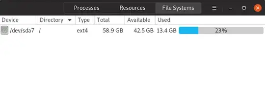

sudo apt purge snapd gnome-software-plugin-snap
Thanks to doug. It feels so clean now, all snap removed.
screenshot
