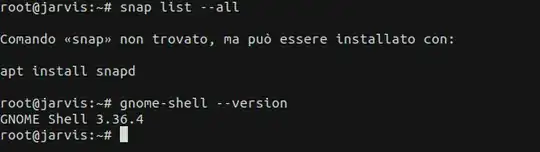

I agree with you about snaps.
I have completely removed snaps from my system by doing this:
sudo apt-get purge snapd
rm -rf ~/snap
sudo rm -rf /snap
sudo rm -rf /var/snap
sudo rm -rf /var/lib/snapd
Now the system works well Although I had to substitute snap programs with their APT or .deb file versions when available. Unfortunately in my case I've lost an application that I need but that's the price I had to pay, but I gained some disk space and my boot time is a little shorter.
gnome is still installed and works regularly as before
gnome shell version shown in terminal
