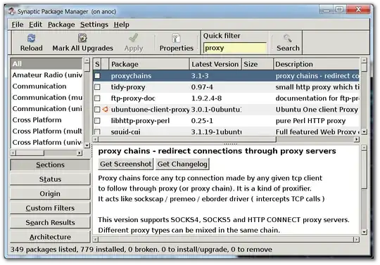

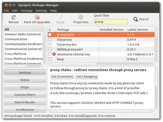

Use Synaptic if you have X-forwarding enabled or are on a desktop
Synaptic is often a more convenient way to do this, but requires at least an X server on your end (unless you're running a desktop environment). Install with sudo apt-get install synaptic if necessary.
  • Synaptic on ssh'd server via X forwarding:
  • Synaptic running locally on Ubuntu Desktop:
