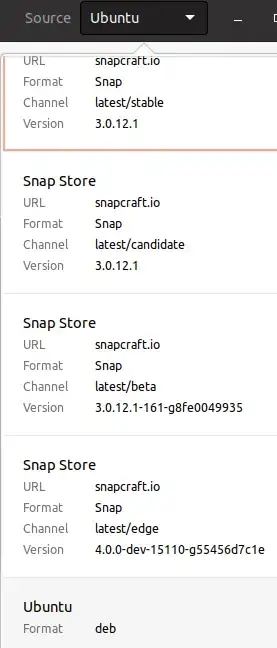

Take, for example, VLC from the Ubuntu Software Center (which has both snap and deb packages available).
If you select VLC you will see a drop down on the header bar to the right. Select the down arrow and you will be provided with a list of VLC packages at the bottom of which (in this case) is the deb package.
This will mean that you will not have to delete the snap store, just select the deb package (if its available) and this will preserve matters for the future.
