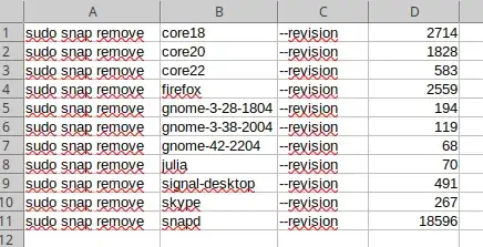

I just did this:
  • List all unused/disabled snap packages:
    sudo snap list | grep disabled
  • Copy & paste the output into a spreadsheet
Usually, the output is in one column. Just do Find & Replace, repeatedly replace double spaces by single spaces until you have only single spaces left.
  • Split your column into several columns using the single space as a delimiter. Every spreadsheet has such a tool. In LibreOffice, it's Data --> Text to Columns.
  • Remove the columns you don't need anymore.
  • Add some columns that hold sudo snap remove and --revision
My ready-to-use commands, in my spreadsheet
  • Just copy & paste your stuff back to the console.
