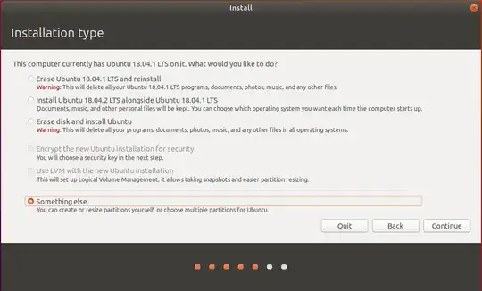

Ubuntu install with "Something Else" option as shown below:
Something Else

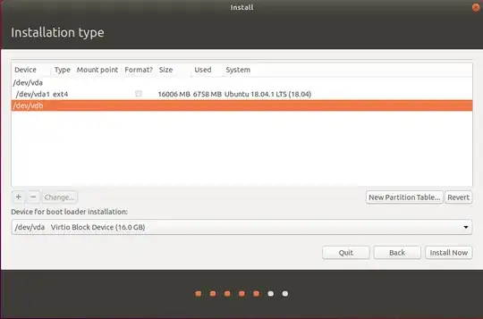

You will see a list of disks and partitions like this:
2 Disks
This may look strange coming from Windows. Take some time to familiarize with this picture. In your case, you may see /dev/sda and /dev/sdb instead of /dev/vda and /dev/vdb. These are the two physical (in my case virtual) disks. My /dev/vda disk has just one partition. It is called /dev/vda1. You will probably have more partitions in your disks with Windows 10. They may be called /dev/sda1, /dev/sda2, /dev/sda3, /dev/sda4 etc. These partitions may be type ntfs.
In contrast /dev/vdb does not have any partitions. This is because this is a new disk unformatted and unallocated. We will install Ubuntu on this disk.

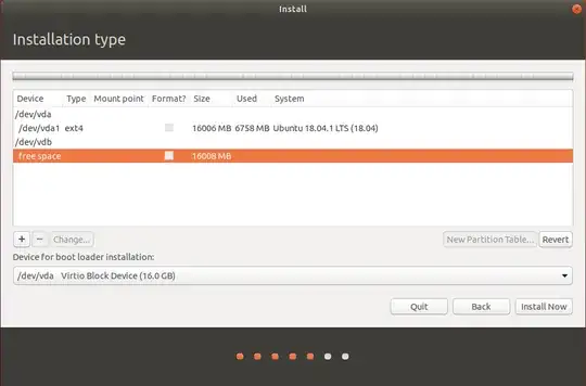

Before we can partition /dev/vdb, we have to make a New Partition Table. to do this highlight the new disk, in my case /dev/vdb and click on the button New Partition Table.... You will see a warning:
Warning
Click Continue. Now you will see a new row below /dev/vdb called free space.
Free Space

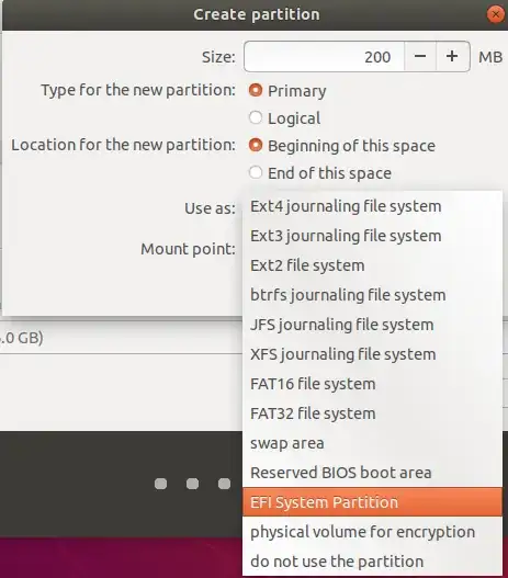

Highlight the Free Space under /dev/vdb and click on the + to create the first partition. The first partition will be a 200 MB EFI system partition. Change the size to 200 MB and the Use as:
ESP Select
The Create Partition window should now look like:
ESP Selected
Once you click OK, you will see partition /dev/vdb1 type efi in the window. Yours may be /dev/sdb1 or something else.

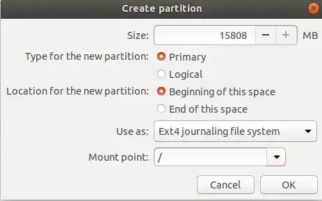

Highlight the free space below /dev/vdb1 and click on the + to create the next partition. This will be the main partition.
System partition
The default installation of Ubuntu just creates these two partitions. So, it is perfectly fine if you want to do the same. In that case just change the Mount Point to / as above. If you want to create an additional /home partition, change the size of the new / partition from the default, to something smaller such as 30000 MB. But this is not necessary. Then you can create a third partition with mount point /home.

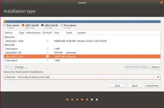

Once done, your disks and partitions will look like:
Final picture
Now click the Install Now button to continue with the installation.
