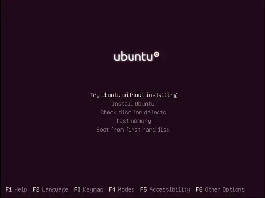

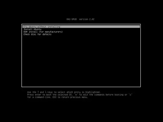

When you boot the Install USB/DVD in UEFI mode you will see a Grub based menu with
If the install USB/DVD boots in the Legacy mode, you will see a graphical page with the these choices:

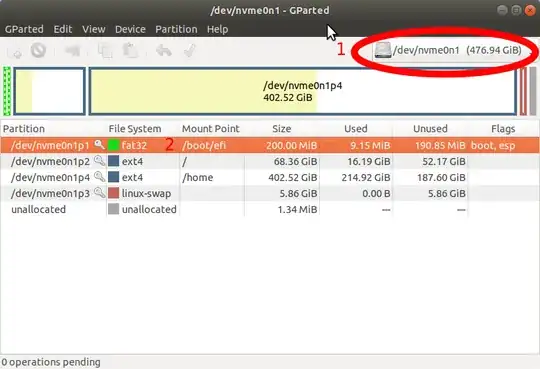

  3. Select the Windows (first) drive within Gparted at the top right corner(1):
The NVME drive in this picture does not have Windows. However, it has an EFI System Partition (ESP).
  1. Highlight the ESP in the bottom list of partitions as shown above (2). Right click on the highlighted partition and select Manage Flags from the context menu. You will see:
You should see two flags, boot and esp checked. Uncheck those two flags. Click Close button to exit the Manage Flag window. Click the green "Apply" button if it is clickable.
You will need to restore those check marks once Ubuntu is installed using the same above process so that Windows can boot from the first drive.

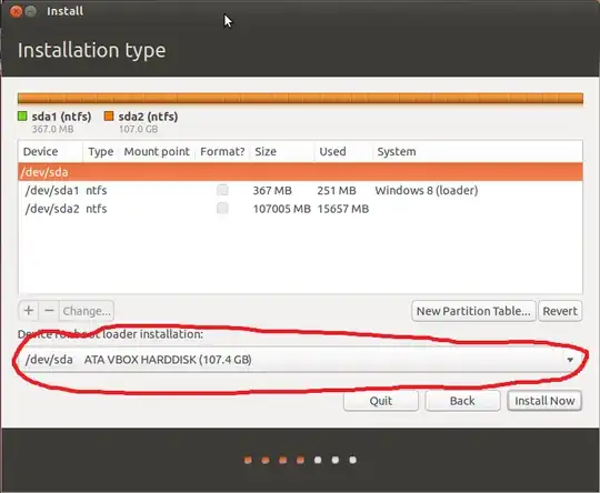

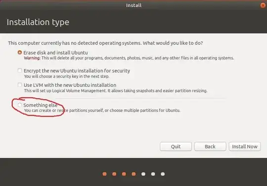

I've never installed ubuntu X windows in different HD's, but I think if you, in the installation, check the option "Something else" in the "Installation Type" screen (image 1), you'll be redirected to the partitions screen (image 2).
In the partitions screen, select the HD you want to install ubuntu (indicated in the image).
After that, continue with the installation and be happy!
