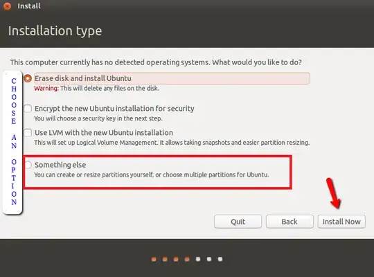

I have already installed Windows 7 on C: drive. Now I want to install Ubuntu on E: drive which is a free partition. How do I proceed?

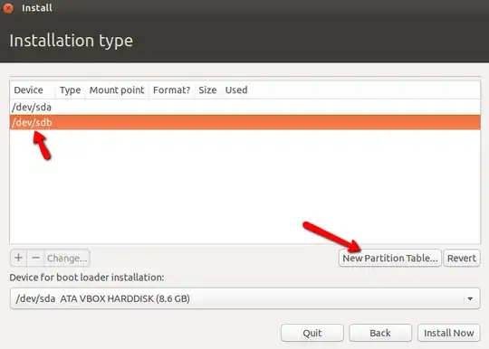

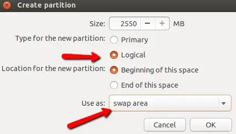

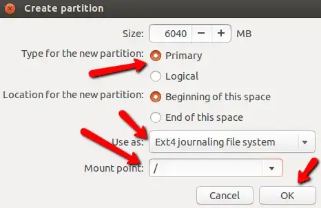

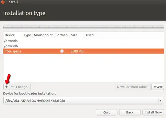

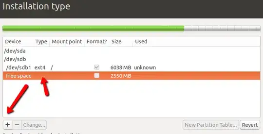

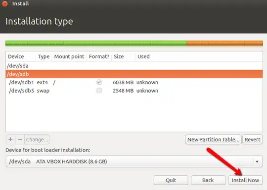

You can install Ubuntu on a separate drive by booting from a CD/DVD or bootable USB, and when you get to the installation type screen choose something else.
The images are instructional. Your case might be different.
Be careful to make sure that you're installing on the right hard drive. If by mistake you install on the C Drive it can cause a problem with Windows.
Just make sure that you read the instructions, especially which hard drive to install to, since Linux lists drives different than Windows. Check the capacity of the drive that you want to assign to Ubuntu, and make sure that you have select the correct hard drive.
enter image description here enter image description here enter image description here enter image description here enter image description here enter image description here enter image description here enter image description here
