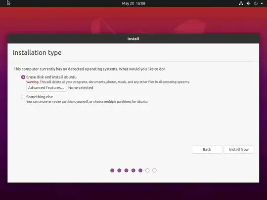

You have two options:
  • You can choose "Erase Disk and Install Ubuntu". This will use the whole Drive 3 and put the Ubuntu bootloader in Drive 3.

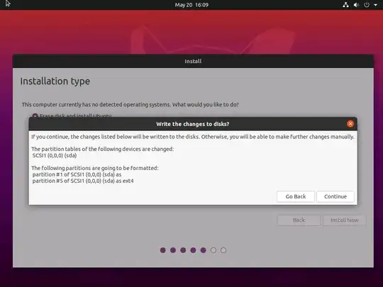

Once you click Install Now button you will be shown how the Drive 3 will be used, as below:
Note: Since only the drive for Ubuntu installation is connected it is designated as /dev/sda in the above picture.
The above picture is interpreted as, installer will create an extended partition /dev/sda1, and a single logical partition /dev/sda5 formatted ext4 inside it.

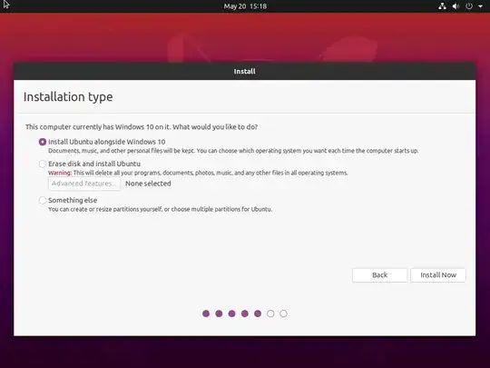

Keeping the drives connected while installing Ubuntu is also possible. You may want to do this if you have never opened a computer case and don't want to unplug and plug cables inside the computer.

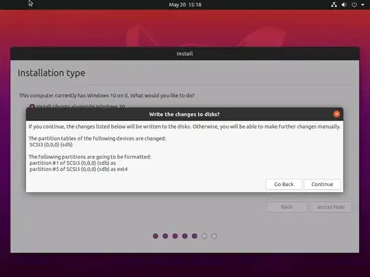

  • You can choose "Install alongside Windows 7" if drive 3 (Ubuntu) has MBR (GPT should work too) but has only unallocated space. That is, all existing partitions are removed before installation. Thanks NMath for the comments.
Note: Since both the drive with Window (Windows 10 in my case) and new drive for Ubuntu installation are connected the Ubuntu Drive is designated as /dev/sdb in the above picture. Yours may be different.
Warning: If you see the option to resize the the Windows partition in Drive 0, then abort installation as Drive 3 was not detected properly.
