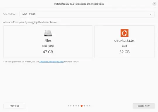

I am trying to install Ubuntu with Windows 11 on my device to make it as multi bootable OS.
I chose the installation Type:
  • Install Ubuntu 22.04 alongside Windows Bootable Manager
I have 2 Drives on my Windows OS:
  • Drive C which Win 11 installed on it.
  • the other drive is D which is empty.
I want to install Ubuntu Desktop on drive D alongside windows. I have selected drive D for installation.
The question here what does Ubuntu partition on the right side mean and Files on the left side represent. Also what the divide slider do between each partition?

In the screenshot you posted, the infographic represents the proposed layout of the disk after installation. The Ubuntu portion tells you where Ubuntu will be installed. The slider allows you to choose how to divide the finite space between the multiple partitions.
There is no such thing as "Drive D" in Ubuntu. These drive letter associations are labels that only exist within the Windows environment and don't pertain to Ubuntu.
You must have enough unpartitioned free space to get the guided installation options to install alongside Windows. You also need to boot the USB as UEFI (unless Windows is installed in compatibility/MBR mode which is very uncommon).
If Windows identifies the space with a drive letter, then the space might already be partitioned. If so, then you may need to delete the partition in order for the Ubuntu installer to recognize it as available for installation alongside Windows. It must be unpartitioned free space.
