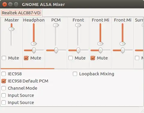

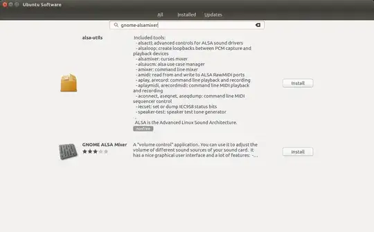

Install GNOME alsa mixer which is in the universe repository (activate the universe repository in your software sources by running Software & Updates and insuring the 2nd box from the top is checked) then Install via Ubuntu software.
gnome-alsamixer
run it and you'll see a screen like this:
gam
unmute everything by clearing the mute checkboxes , then check the IEC958 checkbox.

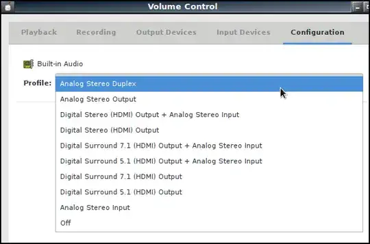

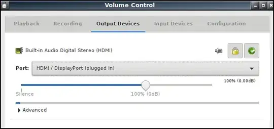

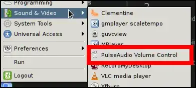

Open PulseAudio Volume Control
Initially I thought I needed to upgrade something because I could not see HDMI here
But after going to Configuration and selecting a profile with HDMI
You can go to Output and see there your HDMI port. Now the sound goes through the HDMI cable. Nothing to install / update / tweak (in my case).
