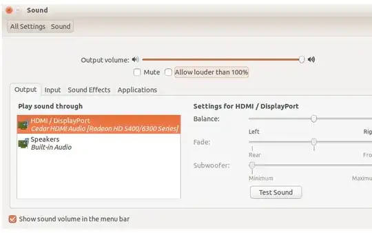

I was having same problem voice is not coming in TV after HDMI cable. I changed my sound setting after that it works perfectly. I changed my default sound setting as shown in image speakers to HDMI.
Sound Setting
