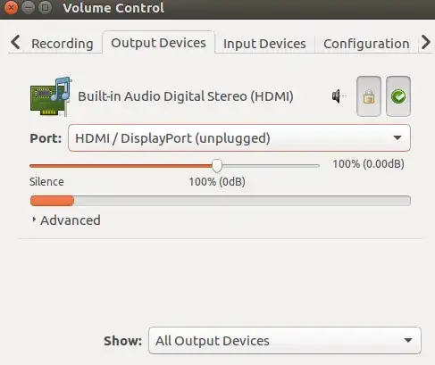

  7. And finally, I had installed pavucontrol and set the configuration as 'HDMI output+Analog Input'.
configuration
There is a dummy output and no sound.
