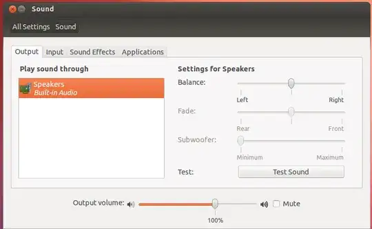

My issue is that I can't get sound to my TV which I connected via HDMI cable to my HP Pavilion g6 Laptop running under OS Ubuntu 12.04-64bit.
Terminal output about audio hardware:

I have no choice in System Settings -> Sound to select HDMI audio output
No HDMI audio
Please can somebody tell me what is missing and what I would have to do?

You can try installing program "PulseAudio Volume Control" (sudo apt-get install pavucontrol) and in tab "Configuration" select profile mentioning HDMI.
