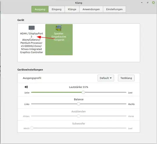

This was cross-site duplicated on Super User How to listen to audio with HDMI on the TV on Linux, the question here (2012) was asked earlier than there (2013). The question here does not have this quick answer that I needed, perhaps since in 2012, it was still another thing.
Mind in your voting that all of this is just copied from the cross-site duplicate. Since cross-site duplicates do not get closed, I want to share the Super User answer here before anyone else runs into the two other answers here without knowing how to fix it in the end like it happened to me.
  • Go to the sound (German: Klang) settings and then
  • choose output (German: Ausgang):
And click on the HDMI output.
