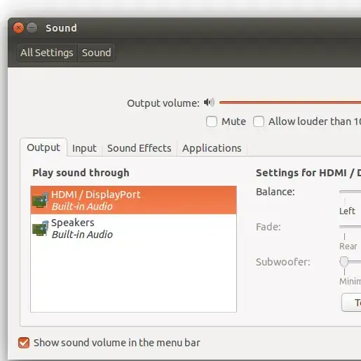

What have I tried so far?
  • I have installed GNOME ALSA Mixer, btsco, PulseAudio Volume Control
I have tried to search with Bluetooth, Cable but it's not showing in Sound while my HDMI port sound display.
