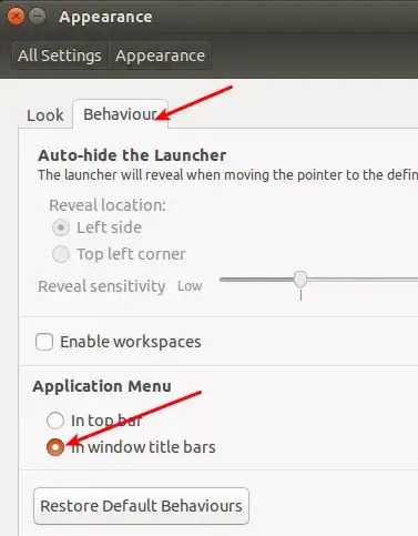

The Global Menu can be optionally switched in favour of Local Integrated Menus (LIM) - aka - more traditional window based menus.
The reason for this additional ability is ostensibly due to the increasing prevalence of high-resolution displays and as such the perceived mouse-travel from application to the global-menu would be relatively large.
To toggle the global menu off or on can be achieved via the appearance control-panel applet:
pic
pic
pic

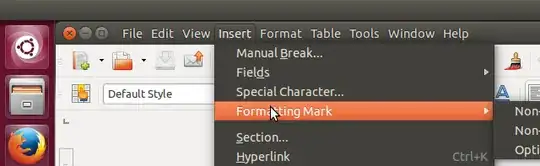

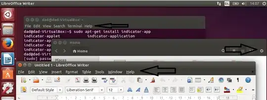

Once clicked, the application menus appear within the window decoration as shown here:
pic
