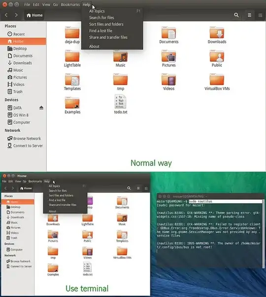

I choose option show the menus in the window's title bar.
It works probably if I run an app in normal way, mean click on icon to open., but when I open it in terminal with root permission, the menu bar is no longer in title bar, it's in "a new part" (I think so) under the title bar.
Gedit and more are the same.

OK This is really a non-answer but there is too much information for a comment and iut may be the only answer.
First here is a bug report for this https://bugs.launchpad.net/ubuntu/+source/unity/+bug/894348
However there is no fix
Heres some info I found Why don't applications opened as root use global menu?
For an application to use the global menu the environment variable $UBUNTU_MENUPROXY needs to be set to to the name of the menuproxy library to be used. For security reasons this variable is cleared when using sudo etc. to run a program as root.
As a side effect this indicates which programs are run as root, otherwise it may be not always clear that the items in the global menu belong to a program running as root.
As this are good reasons for the current behaviour I don't expect it to be changed.
This is really all I could find on this, to give a short answer
There is no fix this seems to be related to security in Ubuntu and root, there will probably never be a fix.
However if it really annoys you, you can remove the global menu (task bare menues) and put them on the windows for all users, like this
sudo apt-get remove indicator-appmenu
And put it back like this
sudo apt-get install indicator-appmenu
If you just want to remove it for the certain apps please review this http://www.webupd8.org/2013/11/unity-global-menu-can-now-be-disabled.html
