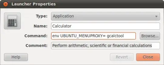

To make it easier to always launch your application with the same appmenu settings, you can edit application launchers in the menu, the gnome-panel, and on the desktop:
  • Gnome-panel and desktop: simply right-click the launcher, select "Properties" and prepend env UBUNTU_MENUPROXY= or env UBUNTU_DISPLAY_BOTH=1 to the value in the "Command" field:
    (source: xrmb2.net)
  • Menu: right-click the menu and select "Edit Menus". In the new window, find the launcher you want to edit and click the "Properties" button on the right. Again, simply prepend the variables like above (don't forget the 'env'), click on "Close" two times and you should be done.
