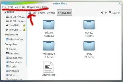

I have a problem to display the menu commands in the window of the nautilus and the terminal (in simple words can not display the file .. help etc..) I see the bar but no writing .. Can you help me see the other windows in the browser type, etc. .. LibreOffice
Image of objective -->
I Use ubuntu 11.10 with Gnome Shell
