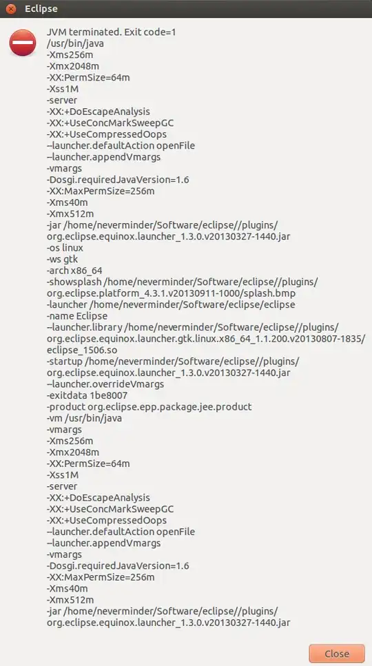

I've installed Scala IDE plugin and tweaked eclipse.ini file according to their suggestions here. For some reason eclipse gets upset about that and errors on launch.
It seems to work if I comment out single line:
-vmargs
I don't understand, what's the problem here?
This is my eclipse.ini file:

This is the message I get when eclipse fails to launch:
error message
UPDATE: Eclipse version: 4.3 (Kepler) 64bit, Ubuntu version: 13.10 (Saucy Salamander) 64bit, Java version: Oracle 1.7_40 64bit

UPDATE3: I run eclipse from it's folder in command line like this: gksudo ./eclipse &. I have to run it as a root because otherwise there is a bug that disables main menu dropdowns. which eclipse gives me nothing, probably because I just downloaded/unpacked it directly from eclipse.org and there is no command associated with it.
Caballero
  • 335
I've cleaned up your eclipse.ini. It is tested it with Eclipse 4.2 Juno. Please report if it works with your scala plugin:
--startup
plugins/org.eclipse.equinox.launcher_1.3.0.v20130327-1440.jar
--launcher.library
plugins/org.eclipse.equinox.launcher.gtk.linux.x86_64_1.1.200.v20130807-1835
-product
org.eclipse.epp.package.jee.product
--launcher.defaultAction
openFile
-showsplash
org.eclipse.platform
--launcher.XXMaxPermSize
256m
--launcher.appendVmargs
-vmargs
-XX:PermSize=64m
-XX:MaxPermSize=256m
-Xms40m
-Xmx512m
-Xss1M
-server
-XX:+DoEscapeAnalysis
-XX:+UseConcMarkSweepGC
-XX:+UseCompressedOops
-Dosgi.requiredJavaVersion=1.6
For future reference: Be careful adding options to you eclipse.ini. Take special care about what goes before -vmargs and what after it.
