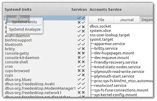

The application has two main view. One is Systemd Units and other one is Systemd Analyze. You can switch it with the label in top-left corner. See the screenshot.
Swithch Between Views

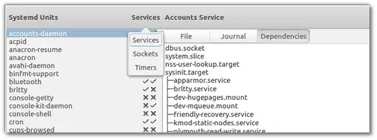

And There are three types of units you can manage. Servcies, Sockets and Timers. You can switch between them. See the screenshot.
Switch between unit types

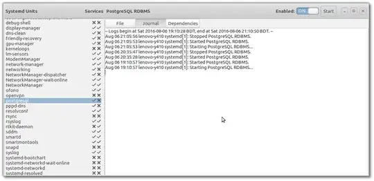

The three main tabs are Files, Journal, Dependencies.
  • Files is the selected unit's configuration file.
  • Journal is the live systemd's output while enabling/disabling/starting/stopping units
  • Dependencies shows what other services or units must be enabled to start a selected service.

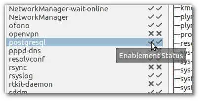

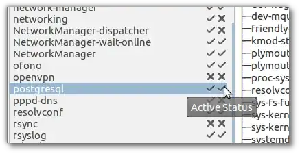

Status Indicators
There are two columns beside the name of units to indicate the Status. Left one indicates whether that unit is enabled to start at boot and the right one indicates whether that unit is currently running. See them in picture.
Enabled at boot status
Currently running status

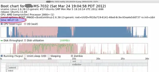

I just ran across this the other day. Its "e4rat" Instructions Here
This little app is amazing.
I took an overtired single processor AMD sempron running at 2800+ which normaly boots Natty at 1.45 mins to 27.885 secs.
I have the boot-charts to prove it. Its crazy! enter image description here
