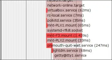

For graphical detailed view of your boot procedure you can generate a plot image:
systemd-analyze plot > bootimage
Now you can open bootimage with eg. eog or different image viewer and check how much time services are taking (and eg. where system stops when booting). It will look like this:
As we can see e.g virtualbox.service is taking 62ms which is very nice but mounting my F3 disk is not so fast. I can consider to disable automounting (it's kinda bad example because systemd is lanuching services in parallel mode and this service is not slowing boot time, nothing depends on it but this is how it works). (In your dmesg output there is something wrong with mount options. You can check in /etc/fstab)
If you want do disable any service it is good to know if something else is not using this service as dependency. You can check it on e.g virtualbox.service example :
systemctl list-dependencies virtualbox.service --reverse
The output shows there aren't any service files related. So if I don't need it I can stop and disable it without any complications:
sudo systemctl disable virtualbox.service --now
If you find some services in your system which are taking long time to load first read about what it is exactly doing and then try to fix related configuration files or if you don't need it disable it.
