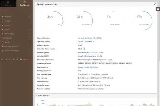

You can do almost the same thing with webmin. From Webmin's homepage:
What is Webmin?
Webmin is a web-based interface for system administration for Unix. Using any modern web browser, you can setup user accounts, Apache, DNS, file sharing and much more. Webmin removes the need to manually edit Unix configuration files like /etc/passwd, and lets you manage a system from the console or remotely. See the standard modules page for a list of all the functions built into Webmin.
To install it, run the following command from a terminal window:
First, add the repository:
sudo bash -c 'echo "deb http://download.webmin.com/download/repository sarge contrib" >> /etc/apt/sources.list'
Then install the key:
wget http://www.webmin.com/jcameron-key.asc
sudo apt-key add jcameron-key.asc
Then update and install webmin:
sudo apt update
sudo apt install webmin
Installation instructions came from: http://www.webmin.com/deb.html
After it is installed, then you can access it by opening a browser to https://localhost:10000/
Login as a registered user on the host that has sudo access.
Hope this helps!

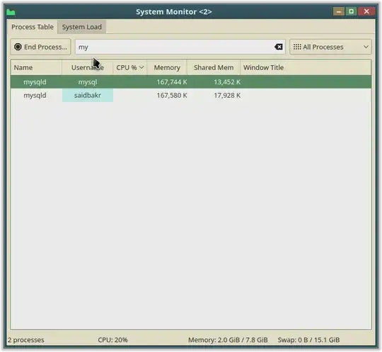

Now I'm using Kubuntu 18.04 and I found a nifty built-in tool for this purpose it is ksysguard print it in the terminal to open it like the following screen shot:
