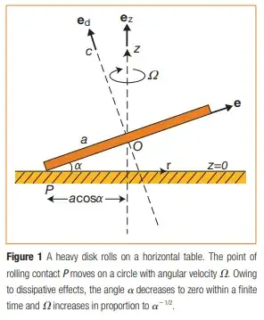

I started from the paper "Euler's Disk and its finite-time singularity" by H. K. Moffatt (2000) [paper 1], and there is presented that $\omega = -\Omega\sin(\alpha)$ and $\Omega^2\sin(\alpha) = \frac{4g}{a}$, and then through an analysis through approximations leads to a result for $\approx \alpha(t) \rightarrow \,\approx \Omega(t)$ showing the finite time blow up approach (which can be seen directly indeed since a the time the motion stop $\alpha \to 0$ so $\Omega = \sqrt{\frac{4g}{a\sin(\alpha)}}$:
Image from paper 1

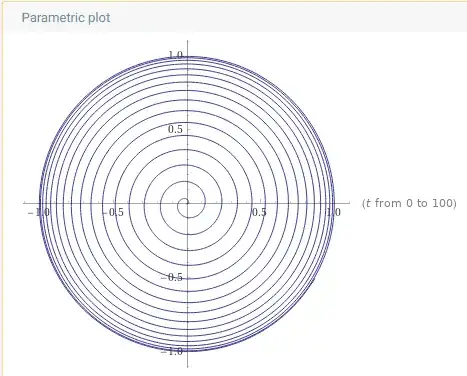

Using the finite duration solution $x(t)/x(0)$ at $n=2$, I will use as Ansatz 1 that the radius of the bounded spiral is given by: $$r(t)= a\left(1-\frac{1}{4}\left(1-\frac{t}{T}+\left|1-\frac{t}{T}\right|\right)^2\right)\cong a \cos(\alpha(t))$$
For a disk radius $a=1$ and an ending time $T=100$ (unitless for now), the parametric plot in Wolfram-Aplha of the finite bounded spiral is:
finite duration bounded spiral example
Which look reasonable since the pitch is always decreasing and the spiral achieve a bound in finite time.

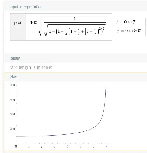

Even so, If I plot $\Omega(t)$ using the corresponding $\sin(\alpha(t))$ by trigonometry it will have the form: $$\Omega(t) = \sqrt{\frac{4g}{a\sin(\alpha)}} \equiv \sqrt{\frac{4g}{a\sqrt{1-\left(1-\frac{1}{4}\left(1-\frac{t}{T}+\left|1-\frac{t}{T}\right|\right)^2\right)^2}}}$$ Now, if I plot it using $\sqrt{\frac{4g}{a}}=100$ and $T=7$ then $\Omega(t)$ will have a plot as:
plot from Omega using Ansatz
Which, even when "almost nothing has been done" for fitting the solution to realistic results, if I compared it with the measured values of the wobbling rate plotted on paper 2 they look quite similar:
Image of Figure 5 from paper 2
But even when the result seen reasonable and similar to the experimental values, since Ansatz 1 force Assumption 2 to happen, things related to the reciprocal will necessarily run to infinity because of having a singularity at time $t=T$ (at least here I shown is true for the reciprocal of the solutions of the family of differential equation listed above), and recently I post a question here and here with a similar result, and both were heavily downvoted and then closed, so after continuing I want to know if the Ansatz 1 make sense from the point of view of physicians (this is why I listed every step for finding the ansatz).

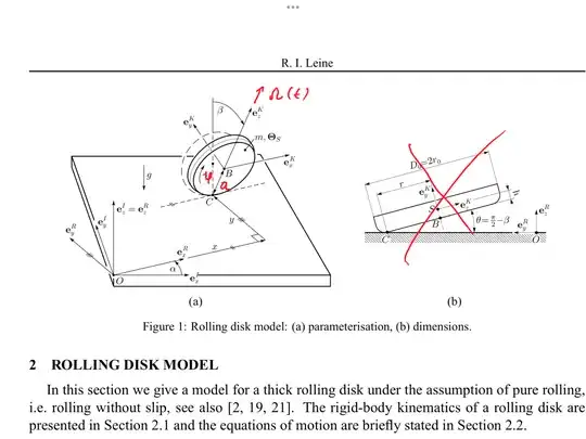

MEASUREMENTS OF THE FINITE-TIME SINGULARITY OF THE EULER DISK R. I. Leine Institute of Mechanical Systems, Department of Mechanical and Process Engineering, ETH Zurich, CH-8092 Zurich, Switzerland, remco.leine@imes.mavt.ethz.c
I am not sure if this help you

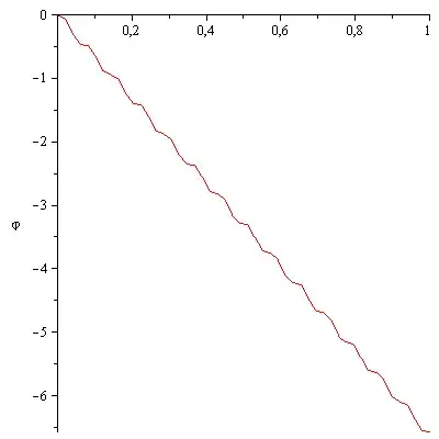

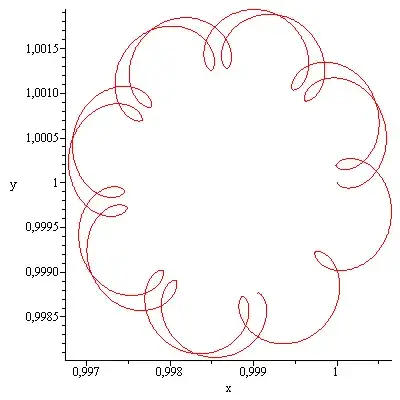

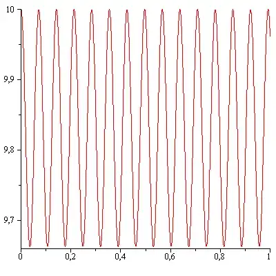

the simulation results of the non linear equations
