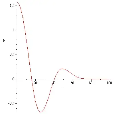

numerical result of
$$\ddot \theta+a\,\text{sgn}(\dot\theta)\,\sqrt{|\dot\theta|}+b\,\sin(\theta))=0\tag A$$ $~a=0.02~,b=0.021~$ enter image description here
