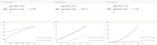

With this, if I "make" a drag force of the form $F_*=a\,\text{sgn}(\dot{x})\sqrt{|\dot{x}|}\left(1+|\dot{x}|^{\frac{3}{2}}\right)$ it will be fulfilling:
  1. from speeds $0.05<\dot{x}<1$ the force $F_* \approx a_1\dot{x}$ relatively well, so it behaves similar to Stokes' law at law speeds - at least it "look like" is linear/affine function, since a little offset is required for made the match.
  2. from larger $\dot{x}$, actually it behaves really closed to a quadratic function $F_* \approx a_2(\dot{x})^2$, so it could be modelling the drag force for high speeds
  3. from really small speeds $\dot{x}<0.05$ the force $F_*$ keeps the LNL behavior so keeps open the possibility if achieving finite extinction time.
Here the plots of the three regimens to view exactly what I have been comparing: Comparison of Stokes'law, drag force, and proposed term

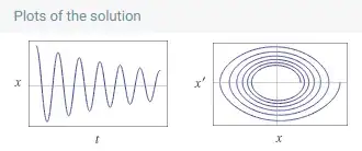

So, for trying to achieve a full phase space diagram, I started the simulation with a lower angle for the pendulum: $x(0)=\frac{\pi}{25},\,x'(0)=0$ and it looks like indeed under this configuration the pendulum is achieving a finite extinction time, but unfortunately the plot versus time is really bad, but it looks it have already stops moving:
modified pendulum for x(0)=pi/25
This is interesting I think, since every traditional model for the pendulum I am aware of, will be continually spiraling towards the point $(0,0)$ forever without never achieving it.

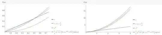

As example the images compare the following drag forces for a common constant $a=1$: $F_d = a\ v$, $F_d = a\ v^2$, $F_d = a\ \left(\frac{v}{2}+v\ |v|\right)$, and the "improved" version: $$F_d = a\ \text{sgn}(v)\sqrt{|v|}\left(\frac{\sqrt{2}}{4}+|v|^{3/2}\right)$$
Ultimate drag force comparisson
In principle, I believe that the constant $a$ should be $a = \frac{1}{2}\rho\;\!C_D A$, but since the Drag Coefficient is also speed-dependent rigorously speaking $C_D(v)$, I am not really sure if this modified Drag Force will fit by itself the Stokes' Law at low speeds, and obviously experimental analysis is required to see if this mathematical construction is fitting properly reality.

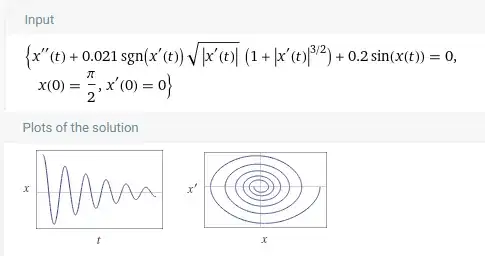

But at least for the pendulum examples reviews above, it still looks is behaving as a decaying pendulum: $$\ddot{x}+0.021\cdot\text{sgn}(\dot{x})\sqrt{|\dot{x}|}\left(\frac{\sqrt{2}}{4}+|\dot{x}|^{\frac{3}{2}}\right)+0.2\cdot\sin(x)=0$$
Modified drag force on pendulum

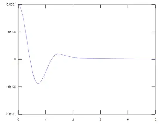

By playing in online Octave with the updated Drag Force I wasn't able to determine if there is a finite time $T$ where the solution becomes exactly zero, but at least it shows that indeed exists a finite time $T$ where it stops oscillating, acquiring only a decaying behavior (differently from the classic solutions for the nonlinear pendulum with friction under the small-angle approximation, that oscillates forever as decaying for vanishing at infinity).
f = @(t,y) [y(2);-0.1*sign(y(2))*sqrt(abs(y(2)))*(sqrt(2)/4+(abs(y(2)))^(3/2))-9.8/0.5*sin(y(1))];
t0 = 0; y0 = [0.0001;0];
opt=odeset('RelTol',1e-8,'AbsTol',1e-10);
[ts,ys] = ode45(f,[t0,5],y0,opt);
plot(ts,ys(:,1),'b');
end of oscillations 1

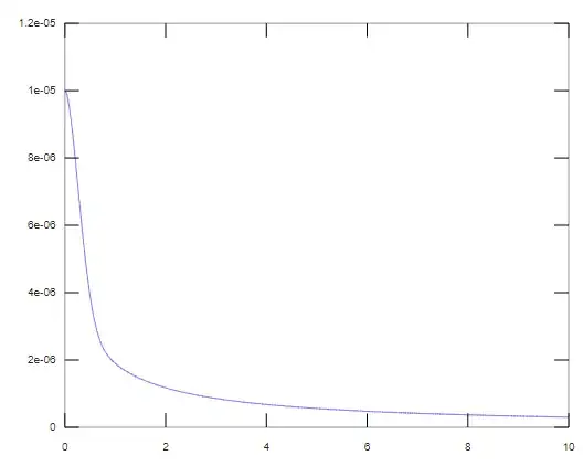

t0 = 0; y0 = [0.00001;0];
[ts,ys] = ode45(f,[t0,10],y0,opt);
end of oscillations 2

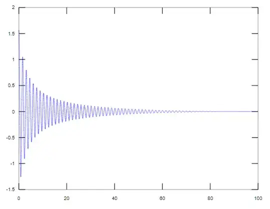

In the following picture it can be seen the overall behavior starting from the angle $\frac{\pi}{2}$:
t0 = 0; y0 = [pi/2;0];
[ts,ys] = ode45(f,[t0,100],y0,opt);
overall behavior
