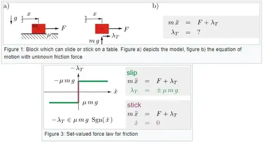

Images from Wikipedia
In this section of the Wikipedia page is shown the differential equation that model the Newton's 2nd law and rules this system: $$ m\cdot x'' = -F - \left(\text{sgn}(x')\right)\cdot \mu_k\cdot m\cdot g$$
Now, assuming that the initial push have already happened, the brick is sliding with an initial velocity $x'(0)$, so the force that have produce this push could be already being considered as $F = 0$ (is absent now from the point of view of the brick), so the only force present is the friction that slows down the brick until it stop moving. If I am not mistaken, dividing from the mass $m$ and matching $k \equiv \mu_k >0$, I will have that the product $k\cdot g >0$ with $g = 9.8\,\frac{m}{s^2}$ the Earth's gravity acceleration constant recovering the differential equation mentioned by @siguc: $$x'' = -k\cdot g\cdot \text{sgn}(x') \tag{Eq. 1}\label{Eq. 1}$$

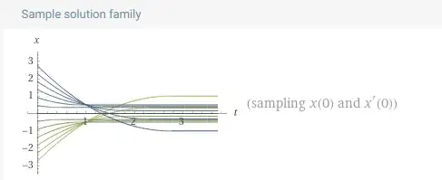

As example, if I let $k\cdot g \equiv 1$ in \eqref{Eq. 1} and I review it in Wolfram-Alpha, it shows \eqref{Eq. 1} could have many solutions with different behaviors (as expected for a nonlinear differential equation):
Wolfram-Alpha solutions
