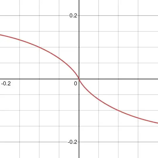

Imagine a point-particle system which position in time is described by the equation: $$x(t)=\frac{t}{2}\log(t^2)$$ and the particle starts moving at time $t_0=-0.2$ with initial speed and the experiments ends measuring its position at time $t_f=0.2$ following the equation $x(t)$. position_vs_time
From the plot it look like something quite feasible to be done, but if I focus on their derivative I will note that there is a point in space where it maximum speed will rise to infinity without any discontinuity on the position of the particle: $$\frac{d}{dt}x(t) = 1+\frac{\log(t^2)}{2}$$
Since the maximum speed diverges $\lim\limits_{t\to 0}\|\dot{x}(t)\|_\infty \to \infty$:

Even if we backed off from current physical laws and considered only the physical laws known prior to Einstein, it still would be unattainable. Not only does the first derivative of the position diverge at $t=0$ but the second derivative also diverges. This means that the force required to make such a profile is infinite. We do not know of any attainable way to produce an infinite force.

From the plot it look like something quite feasible to be done [...]
Then the plot is deceiving, specifically around $t=0$.
