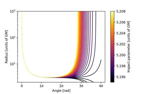

With this all set up, the question can be reframed as such: what is the value of $b$ such that the total variation of $\varphi$ is $3 \pi$? ($1 \pi$ would correspond to going straight, it is the result you get with $M=0$). Further, how small is the minimum value of $r$ in this orbit?
Perhaps there is a clever analytical solution to the problem, but I'll just solve the ODE numerically.
After some manipulations, the problem can be reframed as $$ \frac{\mathrm{d}^2 u}{\mathrm{d} \varphi^2} = - u + 3 GM u^2, $$ where $u = 1/r$. The impact parameter is used here as an initial condition: the initial value problem is $u(0) = 0$ (meaning infinite radius, concretely some small number is set for the integration to work) and $u_\varphi (0) = 1/b$.
For convenience, I express radii in units of $GM$.
The ODE is quite "finnicky", in that the configuration you are looking for only happens in a very specific range for $b$, which (if I didn't mess up the integration) is around $b \approx 5.2GM$.
This is what is required for a full loop, but doing $n$ loops does not move you far from that value of $b$: you only approach the critical value where the photon asymptotically gets closer to the photon sphere.
Schwarzschild photon trajectories.
For the specific answer to the question, the configuration yielding $\Delta \varphi = 3\pi$ seems to be $b = 5.203GM$, and the minimum radius reached by the orbit is about $3.09GM$ (just above the photon sphere!).

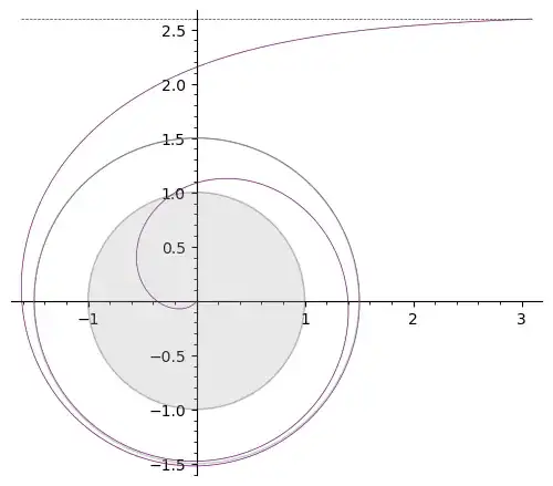

Sneppen found a nice formula relating $\delta$ to the number of times a photon orbits. If a trajectory with a given $(u_0,\phi_0,\delta_0)$ orbits the BH once then a trajectory with $(u_0,\phi_0,\delta_0e^{-2\pi n})$ is almost identical except that it orbits the BH $n+1$ times.

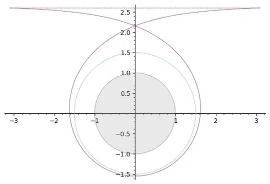

Here are some examples, with $\phi_0=40°, r_0=\frac{b}{\sin{\phi_0}}$. That value is a reasonable approximation for these diagrams, but I really should find $r_0$ by integrating the equations of motion (using $w$ and $\frac{dw}{d\phi}$) from $\phi=0$ to $\phi=\phi_0$.
I'll use $\delta_0=0.003349145847$ because it gives a nice symmetrical trajectory for that $\phi_0$.
Here's the 1 loop escape orbit, with $\delta=\delta_0$. 1 loop escape

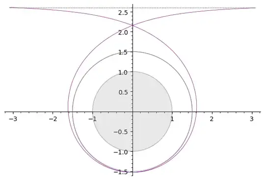

Here's the 2 loop escape orbit, with $\delta=\delta_0e^{-2\pi}$. 2 loop escape

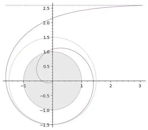

Here's the 1 loop capture orbit, with $\delta=-\delta_0$. 1 loop capture
Here's the 2 loop capture orbit, with $\delta=-\delta_0e^{-2\pi}$.
2 loop capture

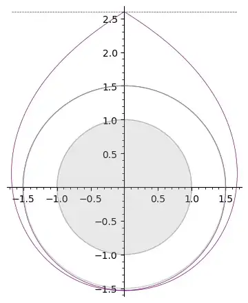

Here's a 1 loop orbit which returns to its starting point, with $\delta=0.0000133371604, \phi_0=90°$, using $2880$ steps.
1 loop return
The black hole's event horizon is the gray circle of radius 1, the photon sphere is the greenish circle of radius 1.5. The dotted horizontal line at top of the diagrams is the asymptote to the photon trajectory for a photon sphere orbit (i.e., the photon is launched horizontally, from infinity), so its distance to the centre of the BH is $b_0$.
It's possible to plot trajectories with more loops, but it's very difficult to see the difference between a plot with 2 loops and one with more loops.

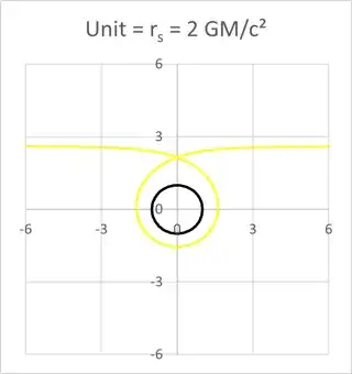

Using the Schwarzschild metric, the value of the impact parameter $ b $ is $ 2.601\ r_s $ (rounded to the 3rd decimal place and with $ r_s $ = Schwarzschild radius = $ \frac{2GM}{c^2} $) for a photon to make exactly one revolution around a black hole.
Photon entering from infinity and exiting to infinity after one revolution around a black hole
With $ (r, \phi) $ radial coordinate and phase angle of the photon, and $ u={1\over r} $, this result can be achieved by a double integration with a 4-th order Runge-Kutta method of the well-known equation: $$ \frac{d^2u}{d\phi^2}={3\over 2}r_su^2-u $$ To the accuracy of integration, two or three complete revolutions correspond respectively to $ b=2.598082\ r_s $ or $ b=2.598076223\ r_s $.
Four complete revolutions are reached with $ b=2.59807621138\ r_s $ which is very closed to $ b_{crit}=\frac{3\sqrt{3}}{2}r_s $.
