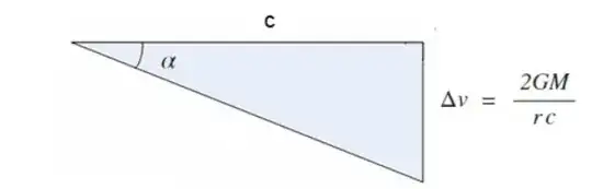

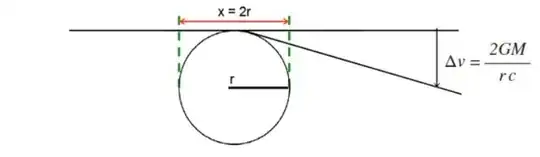

Where the Newtonian Solution is derived from the following example. Consider the Sun with radius r and a photon of light skimming the surface and being diverted through an angle alpha. This angle is obtained by dividing the velocity of the photon in the diverted direction by its speed of light $v/c$.
Where velocity is obtained by multiplying the acceleration of the photon in the diverted direction $\left(\frac{GM}{r^2}\right)$ by the time it takes that photon to travel twice the radius of the Sun $\left(\frac{2r}{c}\right)$. Thus giving the velocity of the photon in the diverted direction $\left(\frac{2GM}{rc}\right)$. Then dividing this velocity by the speed of light $\left(\frac{2GM}{rc}\right)$ / $c$ to obtain the angle that the photon is diverted $\left(\frac{2GM}{rc^2}\right)$.

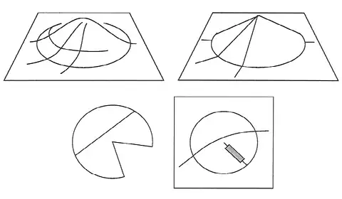

The second term (which, unlike the first, is independent of the speed) comes from the angular defect in the spatial geometry around the sun, the same thing that causes the anomalous precession of Mercury's orbit.
Here are some illustrations from "Relativity Visualized" by Lewis Epstein, which has a good treatment of this.
On the top left is a constant-Schwarzschild-time slice of the Schwarzschild geometry (exterior + interior, though the latter isn't relevant to this problem). On the top right is an approximation of it by a cone surrounded by flat space. On the bottom left, the cone has been cut along a radius so it can be flattened, and a spacelike geodesic drawn on it. The missing pie slice is the angular defect. On the bottom right is a top-down view of the embedding and the geodesic once the cone has been taped together again.
Note that this is not a gravity well. A slower-moving particle would not bend more. There is no speed in this diagram; the deflection angle is set by the geometry.
You can approximate the geodesic of the actual test particle by a zigzag path with (constant-Schwarzschild-time) spacelike and (constant-Schwarzschild-position) timelike parts. On the timelike parts, it experiences a quasi-Newtonian acceleration, and on the spacelike parts it follows something like the path shown in this image. If the deflection angle is small, the total length of the timelike parts depends on the speed but the total length of the spacelike parts doesn't.
