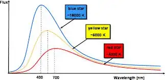

  2. Also, a star is a black body and has a spectrum that looks like this: enter image description here

  2. The amount of the different sorts of EM waves is shown by the curve above

The light that we see coming from the Sun is mainly due to black body radiation at its surface. The spectrum of black body radiation is statistical in origin, and as long as there are enough processes contributing to it the black body spectrum is independant of the microscopic details and depends only on the temperature. There is a discussion of this in the answers to the question What are the various physical mechanisms for energy transfer to the photon during blackbody emission?.
It's true that the fusion reactions in the Sun's core give off photons, but this is only part of the energy output. Energy is also produced as kinetic energy of neutrinos and the helium nuclei. However the energy is given off, it rapidly thermalises with the plasma and ends up as kinetic energy of the components of the plasma (mostly protons and helium nuclei). Energy reaches the surface by a mixture of convection and radiation and ends up heating the surface to about 6,000K. The surface emits black body radiation mainly due to transient dipole formation.
The different spectra you give in your question are simply due to different surface temperatures. The spectra from the surface is unconnected with excatly what's going on in the core.
