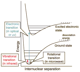

As you said, vibrational and rotational transitions are also possible, and I believe that the energy differences involved there are enough to have a quasi-continuous absorption spectrum in most real-life scenarios (of course, in real life you will never have perfect absorption at all wavelengths).
In the following picture, you can see two energy wells corresponding to different electronic levels. As you can see, every well contains a great number of vibrational levels and an even greater number of rotational levels (only shown at the bottom of one of the wells for clarity)

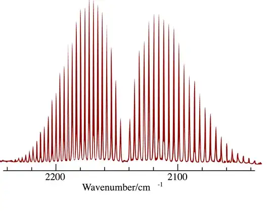

This fact greatly increases the number of frequencies that a material can absorb and can give an almost continuous absorption spectrum in many real-life situations. For example, in the following picture you can see the roto-vibrational spectrum of carbon monoxide. As you can see, it is not so different from a continuous spectrum.
Also notice that, as Rob Jeffries pointed out, real-life spectral lines will extend over a range of frequencies (you can see it also in the previous picture: the lines have finite width,i.e. they are not really lines). See enter link description here for more details.

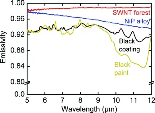

Having said this, we have to remember that a black body is only an idealization. There have been attempts to built nearly-ideal black bodies. Here one of such attempts is described. They have built a "forest" of closely-spaced carbon nanotubes. The single nanotube doesn't have perfect absorbance: it is their structure that is fundamental here. Loosely speaking, incident radiation is partly absorbed and partly reflected within the forest. The reflected radiation propagates in the forest and in every interaction is partly absorbed, until almost all radiation is absorbed. The result is this emissivity (red line in the picture):
Notice that a perfect black body would have unitary emissivity.

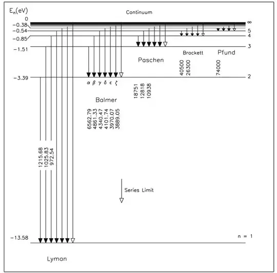

There is only a limited number of high energy transitions as there is only a limited number of electronic energy levels. So how would the spectrum for visible, UV, x-rays and gamma rays be continuous?
Actually the number of electronic energy levels is infinite. As you go to higher energy level, they become more and more closely spaced until they form a continuum (see picture below). If you increase the energy of the incident radiation, at a certain point you will ionize the molecule, that is to say you will rip the electron off. So we could say that the limit is given by the ionization energy, the energy needed to ionize the atom. enter image description here

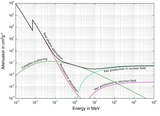

Helium has the highest ionization energy with 25 eV: since that means ultraviolet radiation, it would seem that radiation above that energy cannot be absorbed.
But that is not true. The point is that there are numerous other (more extreme) processes apart from electronic transitions in which radiation can be absorbed: Compton effect, photoelectric effect, pair production... In the following picture you can see the contribution of the various effects.
