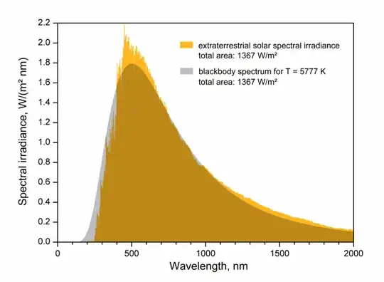

Here is the measured irradiance of the sun and the attempt to fit it with the black body formula:
sun irradiance
The effective temperature, or black body temperature, of the Sun (5,777 K) is the temperature a black body of the same size must have to yield the same total emissive power.
