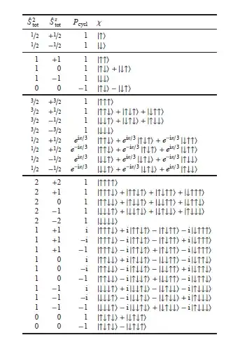

(I actually tried out myself with a large 8x8 matrix. The total spin 1/2 is each doubly degenerate. For the additional quantum number I chose the cyclic permutation. Spin 1/2 states are neither symmetric nor antisymmetric. But what is the usual way to derive this?)
EDIT: For reference I'm adding my results for up to 4 spins from some time ago: enter image description here
If you recall the basics of quantum mechanics with matrices it is actually a straightforward matrix diagonalization and requires no specialized knowledge. However, you still need to find an additional operator which breaks degeneracy. I chose the cyclic permutation, which seems to do the job. Please refer to the below answer, since I haven't checked all details.

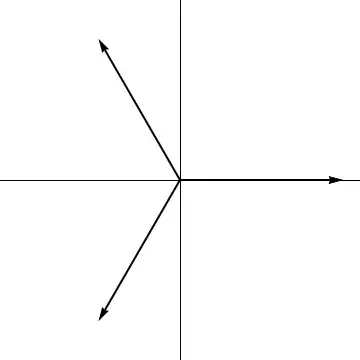

One way to see this is noting that you have three linearly dependent, unit-norm vectors that span a two-dimensional vector space and sum to zero. This is like having three unit vectors on a plane, symmetrically arranged at $120^\circ$ to each other. (The analogy is precise: the Gram matrices, $G_{ij}=\langle\psi_i|\psi_j\rangle=-\frac12+\frac32\delta_{ij}$, coincide, and these encode all the geometrical information about any set of vectors - see problem 8.5 in these notes by F. Jones at Rice.) There is then no way to choose a basis for the plane that is symmetric in the three "electron" exchanges, i.e. one whose symmetry group is the same as the three original vectors, including all three reflections.

The other approach is due to the OP, who provided this image (with slight errors), and which I'll write in full here for completeness. An alternative basis for the plane, which does play well with the electron exchange group - though not as symmetric as one might wish - is to use a complex-valued basis (which is of course perfectly all right) and which corresponds to the circular polarization basis if we think of the plane as the Jones vectors for the polarization of an EM wave. In this analogy, the vectors in the image represent polarizations about those directions. Circular polarization is then invariant - up to a phase - under rotations, but individual electron exchange reflections will flip left$\leftrightarrow$right circular polarizations.
To cut the waffle, the trick in the plane is to take as basis vectors $$ \mathbf{e}_L=\begin{pmatrix}1\\i\end{pmatrix} =\frac23\sum_{j=1}^3 e^{\frac{2\pi i}{3}(j-1)}v_j \text{ and } \mathbf{e}_R=\begin{pmatrix}1\\-i\end{pmatrix} =\frac23\sum_{j=1}^3 e^{-\frac{2\pi i}{3}(j-1)}v_j. $$ These are taken to each other, up to a phase, by the reflections, and to themselves up to a phase by the rotations.
Similarly, for the three electrons you can take the combinations $$ |\psi_+\rangle =\frac{1}{\sqrt{3}} \left[\ket{\uparrow\uparrow\downarrow}+e^{2\pi i/3}\ket{\uparrow\downarrow\uparrow}+e^{-2\pi i/3}\ket{\downarrow\uparrow\uparrow}\right] =\frac{\sqrt{2}}{3}e^{-i\pi/6}\sum_{j=1}^3e^{-\frac{2\pi i}{3}(j-1)}|\psi_j\rangle $$ and $$ |\psi_-\rangle =\frac{1}{\sqrt{3}} \left[\ket{\uparrow\uparrow\downarrow}+e^{-2\pi i/3}\ket{\uparrow\downarrow\uparrow}+e^{2\pi i/3}\ket{\downarrow\uparrow\uparrow}\right] =\frac{\sqrt{2}}{3}e^{+i\pi/6}\sum_{j=1}^3e^{+\frac{2\pi i}{3}(j-1)}|\psi_j\rangle $$ which are eigenvectors of the cyclic permutations with eigenvalue $e^{\pm 2\pi i/3}$, and for which the individual exchanges act as $$P_{12}|\psi_+\rangle=|\psi_-\rangle, \ P_{23}|\psi_+\rangle=e^{\frac{2\pi i}{3}}|\psi_-\rangle, \text{ and }P_{31}|\psi_+\rangle=e^{\frac{-2\pi i}{3}}|\psi_-\rangle . $$
So, in conclusion: this method is not perfect, as it does not give a way to lift the degenerate subspace into two distinct subspaces which are invariant under the full electron exchange group, and which therefore carry separate representations of it. However, it does give a basis that's got a definite action under the exchange group. I would be interested to know what the formal analysis of this action is, and how this generalizes to more than three spins. Maybe for another time!
