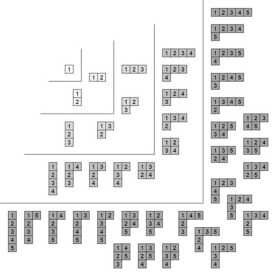

(1) The symmetry can be calculated. The question: "How to understand it" is somewhat subjective. I will outline a very mathematical method that starts with the Robinson–Schensted correspondence (https://en.wikipedia.org/wiki/Robinson–Schensted_correspondence) and then uses Schur–Weyl duality (https://en.wikipedia.org/wiki/Schur–Weyl_duality) to get the answer. [note: those wiki links should be suitably abstract as to be useless]. The technique works for any number of particles, in any number of spatial or spinor dimensions, over any field ($\mathbb R$, $\mathbb C$, and I think some more mathy ones).
Suppose we have $N$ particles (I will use $N=3$). Then, take the integer $N$ and enumerate its partitions (https://en.wikipedia.org/wiki/Integer_partition), e.g.:
$$ 3 = 1 + 1 + 1 $$ $$ 3 = 1 + 2$$ $$ 3 = 3 $$
Those can be expressed as Young diagrams (via the sum of the number of boxes in a row):
Each diagram shows the symmetry: rows are symmetric and columns are antisymmetric, so for $N=2$, the two choices are 1 row ($uu, ud+du, dd$), or 1 column ($uu-du$).
When you set $N=3$, as you pointed out, there are now sets with mixed symmetry. That is the one diagram that is upside-down "L" shaped. It's symmetric in one pair of indices and antisymmetric in the other.
The questions are then: which ones, and how do I enumerate them?
You need to find all the standard Young tableux that fill the diagram. In this case, there are 2, as show here:
Each of those represent a representation of the permutation group on $N=3$ symbols, and the numbers in the boxes represent particle label (or index-count, if you're doing cartesian tensors). From there, there is a procedure to find a permutation called "The Young Symmetrizer" that is applied to particle labels, and that gives you an irreducible basis of states (irrep) to use.
There is also "The Remarkable Hook Length Formula" (https://en.wikipedia.org/wiki/Hook_length_formula) that allows you to compute the dimension of the irrep. What is amazing is that it works for any initial number of dimensions. So for spin (d=2), (aka doublets):
$$ {\bf 2} \otimes {\bf 2} \otimes {\bf 2} = {\bf 4_S} \oplus {\bf 2} \oplus{\bf 2}\oplus{\bf 0_A} $$
which means there is a 4D symmetric quartet $(J=\frac 3 2$), two mixed symmetry doublets ($J=\frac 1 2$), and zero antisymmetric combinations.
