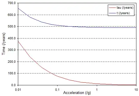

But this isn’t very realistic since it ignores acceleration and deceleration. Suppose instead you travel halfway to the star at constant acceleration, then you flip over and travel halfway at constant deceleration. This allows you to start from rest and end at rest, and you also get a nice artificial gravity during the trip. But how can you calculate the time dilation for a trip that involves acceleration?
The details of the calculation are given in Chapter 6 of Gravitation by Misner, Thorne and Wheeler. I won’t reproduce the calculation here because it’s surprisingly boring. You solve a couple of simultaneous equations to get differential equations for the time, $t$, and distance, $x$, and you solve these two differential equations to get:
$$ t = \frac{c}{a} \sinh\left(\frac{a\tau}{c}\right) \tag{1} $$
$$ x = \frac{c^2}{a} \left(\cosh\left(\frac{a\tau}{c} \right) – 1 \right) \tag{2} $$
In these equations $\tau$ is the time measured on your wristwatch, $t$ is the time measured by the observers on Earth and $x$ is the distance travelled as measured by the observers on Earth. The times $t$ and $\tau$ start at zero at the moment you begin accelerating and leave the Earth. Finally $a$ is your constant acceleration. Note that $a$ is the acceleration you measure i.e. it’s the acceleration shown by an accelerometer you hold while you’re sat in the rocket.
To do the calculation, for example for the trip to Kepler 186f, you take the first half of the journey while the rocket is accelerating and set $x$ to this distance. So for Kepler 186f $x = 245$ light years. Then you solve equation (2) to get the elapsed time on the rocket $\tau$, and finally plug this into equation (1) to get the elapsed time on Earth. This is the time for half the trip, so just double it to get the time for the whole trip. I’ve done this for a range of accelerations to get this graph:
Constant acceleration
Again the blue line is the time measured on Earth and the red line is your time. At an acceleration of only 0.1g the travel time is already down to 76 years (just doable in a single lifetime) and at a more comfortable 1g the travel time is a shade over 12 years.
Since the values aren't that easy to read off the graph here are some representative values:
$$\begin{matrix} a (/g) & \tau (/\text{years}) & t (/\text{years}) \\ 0.01 & 374.9 & 655.9 \\ 0.1 & 76.8 & 509.0 \\ 1 & 12.1 & 491.9 \\ 10 & 1.7 & 490.2 \end{matrix}$$

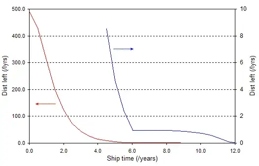

To calculate this effect you work out $x(\tau)$ using equation (2) for the first half of the trip. Since the trip is symmetrical you can reflect about the halfway point to get $x(\tau)$ for the second half of the journey. Then the distance left is just (for Kepler 186f) 490 light years - $x$. Calculate the velocity using equation (3) (again for the first half then reflect about the halfway point). Calculate the Lorentz factor from the velocity and multiply to get the contracted distance left. The results for 1g acceleration look like this:
Distance left
To make the data clearer I’ve plotted the remaining distance for the last half of the trip on an expanded scale to the right. The discontinuity is where the spaceship switches from acceleration to deceleration. The graph shows that the occupants of the ship see the distance they have left to travel shrink rapidly as their speed increases. Conversely, as they start decelerating the Lorentz contraction decreases and the distance left to travel decreases only slowly until they are close to the destination.
