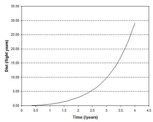

where $d$ is the distance measured in the rest frame e.g. 4.37 light years to Alpha Centauri (the distance measured in the accelerating frame will be different) and $a$ is the acceleration e.g. 9.81 m/sec$^2$ in your example. I did a quick graph of this in Excel with $a = 9.81$ :
Rocket
So for example accelerating at 1g it would take about 2.3 years to reach Alpha Centauri. NB the time axis is time measured on the rocket not time measured on the Earth, while the distance is measured on Earth. That's why you get apparent travel faster than light. The graph of Earth time vs Earth distance would tend to a straight line of gradient $c$.
