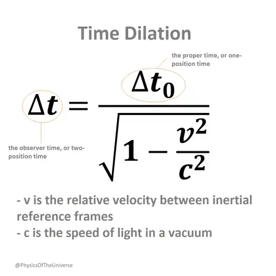

Time dilation is a tricky subject, But mostly vast differentials in time perception require increasing high acceleration towards light speed. enter image description here
Over all, the time frame is negligible. Even if velocities of 1/10th lightspeed were achievable by technical means, the time differentiation to an observer would be 0.005 seconds. It's exponential, speed increases perceived time index. At 1/4 (25%) light speed, observed time 0.03 seconds Put it this way 1% lightspeed, a days worth of travel adds 4.32 additional seconds to the observer' 25% lightspeed, a day of travel to astronaut, is 47 minutes longer to observer .5c o r 50% lightspeed, a day of travel for astronaut vs 3.7 hours added 0.75c a day of travel; = 36.2 hours (day and a half) 0.9c. Observer 55 hours (over 2 days) 0.95c. Observer 76.8 hours (Over 3 days) 0.99c. observer will have spent a week 0.999c. observer (22 days) .9999c. observer (2.5 months)
Traveling 100 lightyears at 0.25c would take the astronaut 400 years but would be 413 years to the observer. At 0.9c, 111 years to reach 100 lightyears, observer would wait 254 years.
