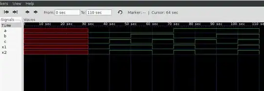

So, I went there and tested! I wrote a small verilog file, simulated and looked at the waveform.
It turns out the correct interpretation for verilog is: There is an odd amount of 1's in the input AKA Interpretation 2 of this article
module top (y1, y2);
output y1, y2;
reg a, b, c;
wire x1, x2;
wire t;
xor(t, a, b);
xor(x2, t, c);
assign y2 = x2;
assign y1 = x1;
xor(x1, a, b, c);
initial
begin
  $dumpfile("test.vcd");
  $dumpvars(y1, y2, a, b, c, x1, x2);
#20
#10  a = 0; b = 0; c = 0;
#10  a = 0; b = 0; c = 1;
#10  a = 0; b = 1; c = 0;
#10  a = 0; b = 1; c = 1;
#10  a = 1; b = 0; c = 0;
#10  a = 1; b = 0; c = 1;
#10  a = 1; b = 1; c = 0;
#10  a = 1; b = 1; c = 1;
end
endmodule
