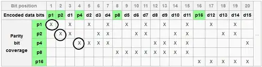

It is done inclusively ie by undertaking the parity bit under consideration, they are designed in such a way that along with the parity bit itself the data word or message bit generates the desired parity type in your case even parity.
Look at the image from wikipedia Parity table
Only parity 1 is included while calculating at position one and so on.
Position 1 Checks data bits -> XOR(1 3 5 7 9 10 12)
Position 2 Checks data bits -> XOR(2 3 6 7 10 11)
Position 4 Checks data bits -> XOR(4 5 6 7 12..)
Position 8 Checks data bits -> XOR(8 9 10 11...)
Remember don't confuse between position and parity number, the bit-stream are numbered (1-n), where n is the size of codeword.
Hence your P1 is position 1,your P2 is position 2, P3 is position 4, and P4 is position 8.

  • I kinda get it. We don't say that P1 covers itself, or can we say that? I need to implement this logic with logic gates, XORs to be specific, so I don't see how P1 would implement itself. – Cesar A Oct 31 '15 at 22:23
  • Do you happen to know how to implement that logic with XOR gates? Or at least could you give me a hint? The logic I am referring to is P1 = XOR(3, 5, 7 ,9, 11) – Cesar A Oct 31 '15 at 22:31
  • As I said it in the answer itself the parity bit along with other position gives you the even parity, as it is at position P1 so position 1 has P1 in it(P1 cover itself and so does P2 ...), also you try cascading multiple XOR gates to get the parity check. For more information XOR gate – MaMba Nov 01 '15 at 08:55
