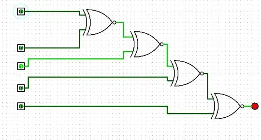

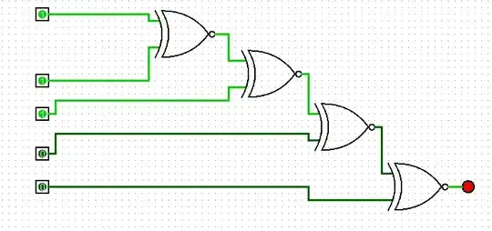

I am a little confused about the role of XNOR operation when we have more that two inputs. After simulation, I realized that when we use multiple two inputs XNOR gates, the resulted output is 1 if there is an even number of 0 at the inputs. I searched on the internet to confirm this but I did not find anything. So my question is: Is my interpretation of XNOR operation true or false?

The NOT part of an XNOR gate can be moved from the output to either of the inputs without changing the function of the gate.
XOR (Not Q) - a.k.a XNOR
| A | B |!Q |
| 0 | 0 | 1 |
| 0 | 1 | 0 |
| 1 | 0 | 0 |
| 1 | 1 | 1 |
XOR (Not A) - a.k.a XNOR
|!A | B | Q |
| 1 | 0 | 0 |
| 1 | 1 | 1 |
| 0 | 0 | 1 |
| 0 | 1 | 0 |
XOR (Not B) - a.k.a XNOR
| A |!B | Q |
| 0 | 1 | 0 |
| 0 | 0 | 1 |
| 1 | 1 | 1 |
| 1 | 0 | 0 |
If you start moving them further and further down the chain, you should see that they start to cancel out with each other. The first two gates cancel to become a pair of XOR gates chained together, as do the second pair. So essentially you've built a 5-input XOR gate.
More generally, for it to be considered an N-input XNOR gate, or even number of 1's detector, you need to construct it from one XNOR gate, and N-2 XOR gates. Essentially you need to result in an odd number of NOTs in the circuit.
If you want to make an even number of 0's detector, you will need to invert all the inputs. You can of course propagate those NOT gates through, at which point you will find that for a even number of bits in your input, the circuit is the same as for an even number of 1's detector. For an odd number of input bits, you want the final gate to be an XOR not an XNOR.
