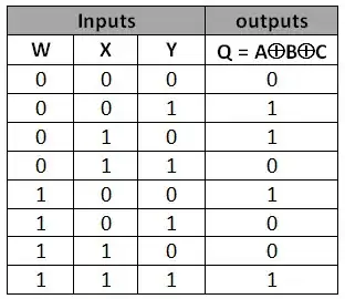

Given the truth table for a 3-input XOR, how come the output is 1 when all inputs are 1? This doesn't logically extend from a 2-input XOR where output is 0 when all inputs are 1. Is there a way to understand this intuitively, or do we need kmaps etc?
xor
(source: electronicshub.org)

    Related http://electronics.stackexchange.com/questions/93713/how-is-an-xor-with-more-than-2-inputs-supposed-to-work – Tyler Jan 16 '17 at 16:22
    Always remember XOR is an odd parity detector, For example an XOR with N inputs will output 1 if only odd number of inputs is asserted – Elbehery Jan 16 '17 at 16:31
    @Elbehery It depends on the definition. And apparently it is ambiguous as the answer in the link above is describing. – Eugene Sh. Jan 16 '17 at 17:00
    There are two definitions for XOR: just one injput is high, or a odd number of inputs is high. For 2 inputs these definitions coincide, for more than two inputs the world seems to be divide 50-50. – Wouter van Ooijen Jan 16 '17 at 18:03
  • A niche little trick to remember this can be odd number of ones give the output one. This trick works with any number of inputs! – ADITYA DAS Jan 28 '24 at 09:21
It may help to break it down: first do \$ A \oplus B = 1 \oplus 1 = 0 \$. Then we have \$ 0 \oplus C = 0 \oplus 1 = 1 \$.
