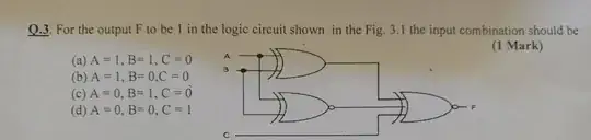

With this assumption the answer to the circuit in the picture should be option A,B, and C. but the correct answer is D. I am confused as to how? enter image description here

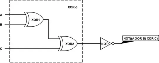

Let's observe an implementation through logic gates.
A three way XOR gate can be implemented with a XOR-2 itself XORed with the remaining input, and remember that any XNOR has then to be rendered as a XOR in series with a NOT gate. Therefore, a XNOR-3 implementation would be:
schematic
This yields a truth table coherent with the functionality expected above (1 when there are an even amount of input at 1). This also shows that a triple XNOR is algebraically rendered as
$$ \text{XNOR-3} \buildrel def\over = \text{NOT} (\text{XOR-3}) = \overline{(x \oplus y \oplus z)} = \overline{(xyz + \overline{x}\overline{y}z + \overline{x}y\overline{z} + x\overline{y}\overline{z})} $$
by carefully expounding all terms, you eventually get to the even parity checker expression which is
$$ \text{XNOR-3} = \overline{x}\overline{y}\overline{z} + \overline{x}yz + xy\overline{z} + x\overline{y}z $$
It follows that: $$\text{XNOR-3} =(x \oplus y)\odot z \ne x \odot y \odot z$$ as mentioned in the beginning.

The last NXOR gate needs to have an even amount of inputs high to output high. This is because a normal XOR gate only turns on if an odd amount of inputs are high. The top two pins can never be both on or off at the same time, because their inputs are connected respectively to the same inputs and are the same type of gate except one is inverted.
Now things should be easier.

  • If I take the case as even number of inputs gives '1' at the output, then the above question's answer is D. But when I tried to solve by algebra method and then find the result, then answer is A, B and C. Where am I making the mistake! – turtle Feb 09 '17 at 11:07
  • @turtle Unfortunately I can't read the algebra because I haven't learnt it, but did you forget to indicate that the last XOR gate is inverted, thus being a NXOR? – Bradman175 Feb 09 '17 at 12:59
  • thanks for the help. I have considered the compliment part. But may be my understanding of the gate is wrong. I am unable to find explanation to convince my solution being wrong :) – turtle Feb 09 '17 at 17:47

According to circuit diagram option D is correct. There is no need to use Boolean algebra for this. Just go through the circuit. Output of 3-input EXOR gate is not same as that for 3-input EXNOR gate.
