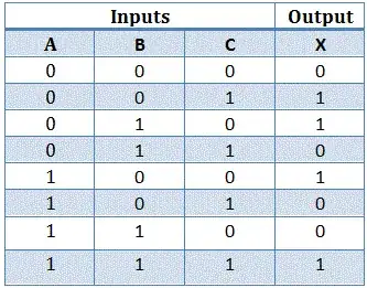

3-input XOR gate truth table enter image description here
The signal probability for a XOR gate with 3 inputs is: \$sp = (1-p_A)(1-p_B)p_C + (1-p_A)p_B(1-p_C) + p_A(1-p_B)(1-p_C) + p_Ap_Bp_C\$

    Note that the behavior of an XOR gate with more than 2 inputs is not standardized. Some interpret this as a "one and only one" function while others interpret it as an odd-parity function. It's far better if you can write everything in terms of the 2-input function. – Elliot Alderson Oct 26 '22 at 12:31

If you look at your 3-input XOR truth table: -
You can see that it can be made from two cascaded 2-input XOR gates: -
  • B and C feed XOR#1 and the output feeds an input of XOR#2.
  • The other input of XOR#2 is from A.
So, now you can derive what the probability of the XOR#2 output being 1 is. And, you can develop that further by using the same technique of cascading XOR gates and deriving the new equation.
