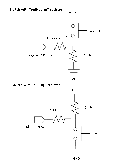

It's the other way around.
Pull up is where you place a resistor between a signal and +V, pull down is pulling it to ground.
Image of pull up pull down.
(from http://roguescience.org/wordpress/?page_id=11)
Here, you can see that when the switch is open, in the pullup scenario the input pin will read high, but for pull down it will read low.
