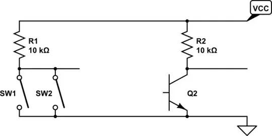

Here are some pullups, used with switches, and an open collector output
schematic
People often ask what value resistor should be used for a pullup. It's a compromise.
  • large resistance to make the 'strength' much weaker than the bottom driver, so that when it's on, the bottom driver can 'win'
  • small enough to drive whatever is following, so that when all the bottom drivers are off, the pullup can 'win' against the load (so it can be different between logic families or non-logic loads)
  • small enough to charge the load's capacitance quickly enough (see how this consideration affects choice of pullups for I2C for instance)
  • large to avoid wasting too much power (different considerations for battery and mains-powered devices!)
  • 10 kΩ is often a good 'first stab' which will work in many situations
To summarise the drive strength issues, I'd like to rewrite your original quote a little as
  • ... to pull the data line if none of the chips are driving it low"
One of the uses of a pulled-up signal line is that any low-side driver can pull it low, performing a wired-OR function. That's why I've drawn two switches on R1's line. If either close, then the line goes low. So to finally answer your question ...
  • If none of the switches (or output drivers represented by switches) are driving it low, then R1 'pulls' that output line 'up' to VCC.

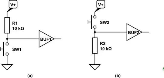

Since you're "great with plumbing" [edited out of original question by @JRE] this may help. (I'm the author of your confusing quote.)
Figure 1. A motorised valve. Image source: PlumbingProducts.ie.
I have a couple of motorised valves in my plumbing system. They use a small motor to open the valve and a spring to close it when the motor is switched off.
In this case the spring is "pulling" the valve closed and the motor is "driving" (a word I should have used in my other answer) it open. Obviously for this to work the spring must be weaker than the motor.
schematic
Figure 2. (a) A pull-up resistor. (b) A pull-down resistor.
In the examples of Figure 2 we can configure a pull-up (to V+) or a pull-down (to ground) very easily. You can think of R1 and R2 as being like the valve's spring and the switches as being much stronger as they have such low resistance compared to the resistors when the button is pressed. In this way they are like the motor driving the buffer input voltage very strongly against the "pull" of the resistor.

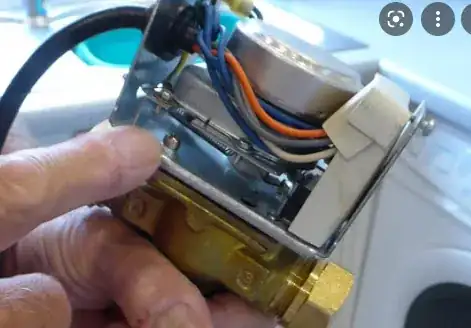

Figure 3. An opened motorised valve. The motor (top) and spring (follow finger) are visible in this still from YouTube video How to renew a three port motorised valve head. No draining down.
